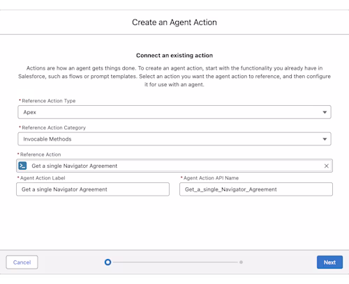

In the pop-up window (figure 2), specify the reference action type and category. Choose Apex for the type and Invocable Methods for the category. Then select the Apex class you just created by choosing the label that matches the @InvocableMethod annotation in your class.
