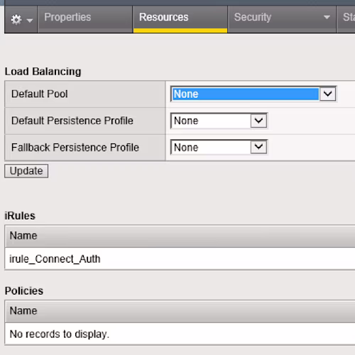

Add the iRule for Access Control
Add the iRule shown above to the F5. Then add the rule to the configuration by using the Resources tab:

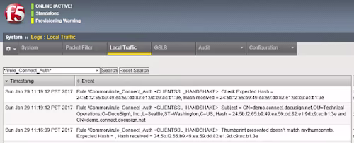

Send a test Connect notification
Send a test Connect notification message and check the F5 log. You should see a log entry with the certificate’s MD5 hash value and its common name:
The presence of the Docusign certificate’s common name in the log shows that Mutual TLS worked.
Copy the MD5 hash value and the lookup string “CN=demo.connect.docusign.net” to your AuthThumb lookup table:
