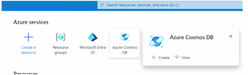

  1. Under Azure Services, select Azure Cosmos DB
  2. Select Azure Cosmos DB for NoSQL
  3. Configure as needed. Note down the Account name and save. Below is an example of the configuration for this example.
  4. Navigate to the created resource.

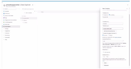

  5. Add a new Database named: Accounts-DB
  6. Add a new Container named: Accounts with Primary Key: account_holder_email
  7. Add a new item under the Accounts container using the data model below. Paste it in and save (test values can be modified):

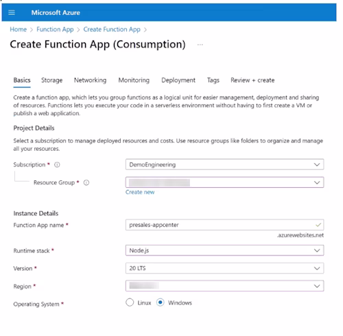

  1. Navigate to Azure Home > Function App > Create
  2. Enter a name for your Function App.
  3. Add the resource group and other relevant information.
  4. Select Review + create, then Create
For more information, see Microsoft's Azure Functions opens in a new tab documentation.

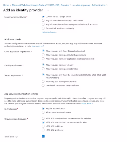

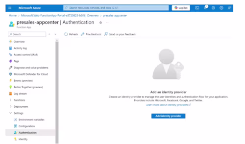

Step 3: Set up OAuth for the Functions App
Securing the Functions App with OAuth ensures that only authorized requests can access your application logic. This step creates an App Registration and captures the credentials (client ID, client secret, authorization URL, and token URL) that you will need when configuring the app manifest.

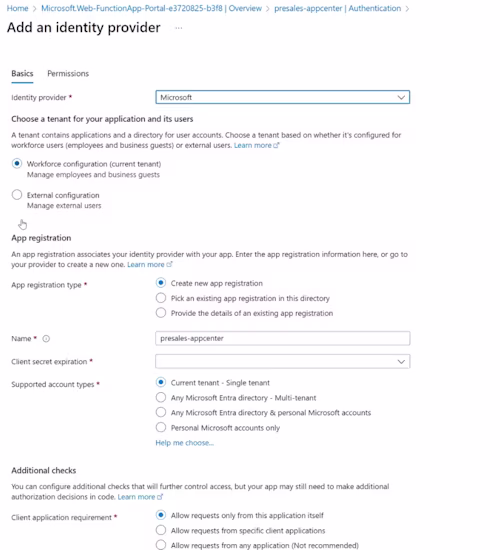

  1. Navigate to Settings > Authentication in the Function App.
  2. Select Add identity provider and choose Microsoft
  3. Select Create New App Registration
  4. Set Unauthenticated requests to HTTP 401
  5. Set the client secret expiration date and click Add

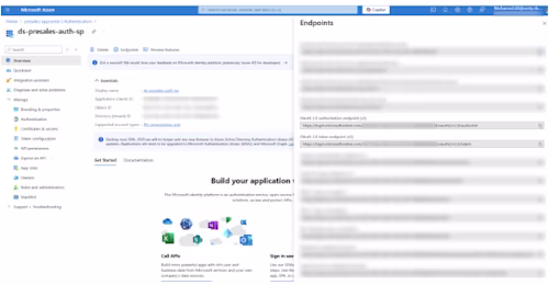

Save the following values to a notepad, you will need them for the app manifest:
  • Select Edit on the newly created identity provider.
  • Copy the Application (client) ID → this goes in the manifest clientId attribute.
  • Copy the MICROSOFT_PROVIDER_AUTHENTICATION_SECRET → this goes in the manifest clientSecret attribute.
  • Navigate to the Identity Provider page by selecting the provider name, then select Endpoints
  • Copy the OAuth 2.0 authorization endpoint (v2) → this goes in the manifest authorizationUrl attribute.
  • Copy the OAuth 2.0 token endpoint (v2) → this goes in the manifest tokenUrl attribute.
    Important: Your notepad should look like the following.

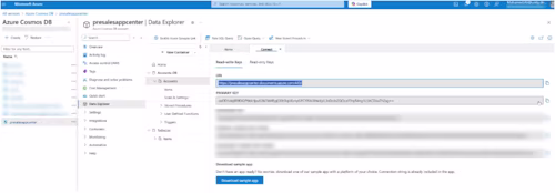

Step 6: Add environment variables
Environment variables allow the Functions App to connect to your Cosmos DB instance without hardcoding credentials in the application code. This step adds the Cosmos DB endpoint and primary key as configuration values in the Functions App.
The Functions App needs your Cosmos DB credentials as environment variables.
  1. Go to Cosmos DB > Data Explorer > Connect
  2. Copy the URI → save as COSMOSDB_ENDPOINT
  3. Copy the PRIMARY KEY → save as COSMOSDB_PRIMARY_KEY
  4. Go to Function App > Settings > Environment Variables, click + Add, and enter:
    • Name: COSMOSDB_ENDPOINT / Value: (your URI)
    • Name: COSMOSDB_PRIMARY_KEY / Value: (your PRIMARY KEY)
  5. Click Apply and confirm

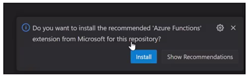

Step 7: Deploy and test function code
With all resources configured, this step covers downloading the function code, deploying it to Azure, and running a test query to confirm that the Functions App can successfully read data from Cosmos DB.

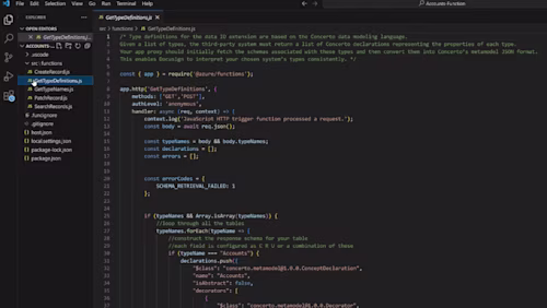

  1. Clone or download the function code from the GitHub repository. opens in a new tab
  2. Open the project folder in VSCode.
  3. Install the Azure Functions extension for VSCode.
  4. Sign into your Azure account via the Azure Functions panel (left sidebar).
  5. Select the thunder icon next to WORKSPACE, then select Deploy to Azure
  6. Select Deploy. You will see a "Completed" message when finished.
  7. Confirm deployment by verifying that 5 functions appear in the Azure Function App with status Enabled.
